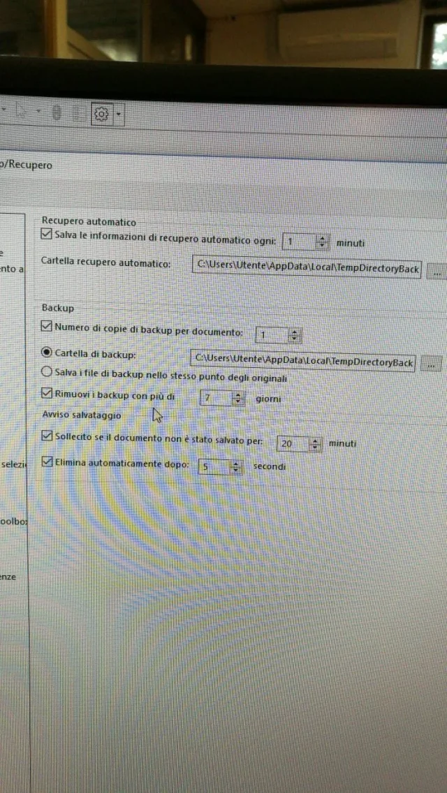

in system options, backup/recovery there are these settings.you know how to tell me if they are okay?
I would put more backup copies so I can go back some saves.
Weekly deletion would say I turned it off. I do cleaning when I say... Or maybe I miss something I need.
