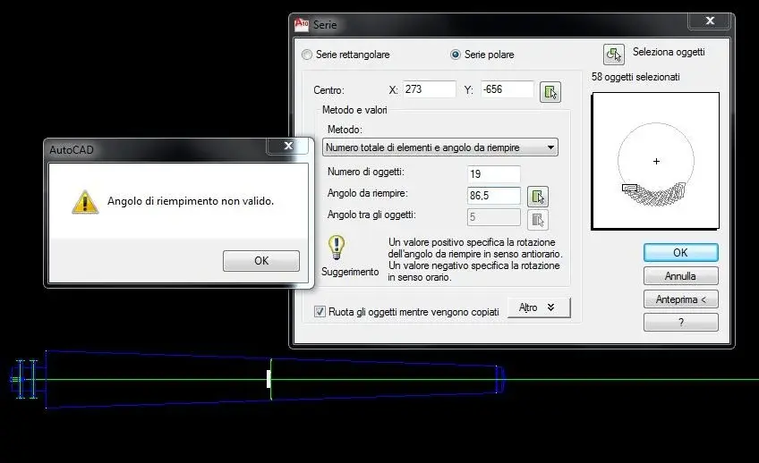

Good morning, I was trying to create a circular repetition when I first noticed that autocad does not accept decimals.... :eek:
I also tried "select angle to fill" but I didn't know how to give it the two lines... a line appears and it only makes me remove another point... :confused:

go to the "design units" window (unit control) and increase the accuracy of the corner decimals.
are different things the approximation of quotas, from the unit settings
you can have units set with 1 decimal and odds set to 3 decimals, like the reverse.
and both the approximation and the units can vary independently between linear and angular units (you can have 4 decimal linear units and 2 decimal angles).
attention that, regardless of the units set, autocad always thinks with full decimal. if you divide a 10 long line into 3 parts, it will be 3,3 periodic long regardless of the number of Decs set with units.
