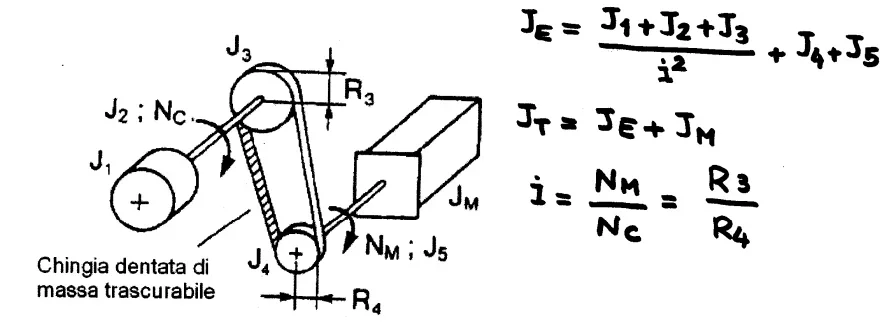

good evening, I continue implementing with another case, all right until I have a motor and a single gearbox (or any organ that creates an i1 relationship.
but in case (as in the attached image I also had a second i2 created by belt how do you proceed?
substantially having noticed the mass to be moved on a conveyor belt of m=100 kg with an acceleration of 3 mm/sec and fixed the dimensions of the wheels of the belt (i2= 1/3).
how do I choose the engine and the gearbox ratio?

with mass to be transported, acceleration and coefficient of friction calculations the necessary torque for handling (net of yields).
you also need the speed of transport so you can calculate inertia of the conveyor belt pulley.
then in cascade reduces everything until the engine, conceptually the process does not vary
it has already been schematized in other my posts the cinematism just proposed....and with it how the inertias are calculated.
clearly serve friction, acceleration and speed.
is the composition of1602791157524.webpregarding the weight, the carpet and what happens to the tree up to what would be the engine of this box.
what you find, you have to apply it to the other scheme:1602791240209.webpwhere instead of this engine there is again a scheme:1602791294407.webp
