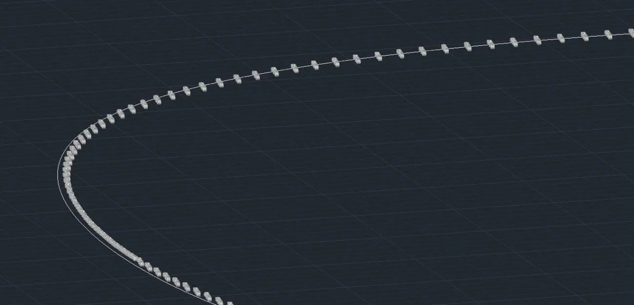

hi guys, use autocad 2018 to make jewelry from me created, I'm trying to make a necklace but the thing is very elaborate and unsuitable for different views.
I started with drawing a single mesh, I copied it and rotated to frame it to the first, I created a group of the two pieces and an ass of the path I want to make him do, then through the serial command along trajectory I made it elaborate.
result : the group turns around the spline but each group remains to itself, as you can see from the annex.

autocad is not a 3d program, so it is not suitable for any industry if you want to model.
a program used in jewelry is rhinoceros, it is not parametric but has many functions for modeling "artistic"
Thank you very much, I with the 3d tools function of autocad I have designed several components ready to be printed, but I agree with you that it is not a suitable software as very limited, I wanted to understand if for my incompetence or because there are other more consonant programs like rhino.
It's a 2d cad, you can't ask him to be a solid modeler.
rhino is definitely more indicated, you should also understand what you need to model.
It could also be good for a parametric cad, the important thing is that it has good tools for modeling the super factories.
also powershape is very powerful for surface modeling (and solid, for some years)
if you place a knit in .step format (or even .stl) and tell us the diameter of the necklace maybe someone does a test without losing a life
