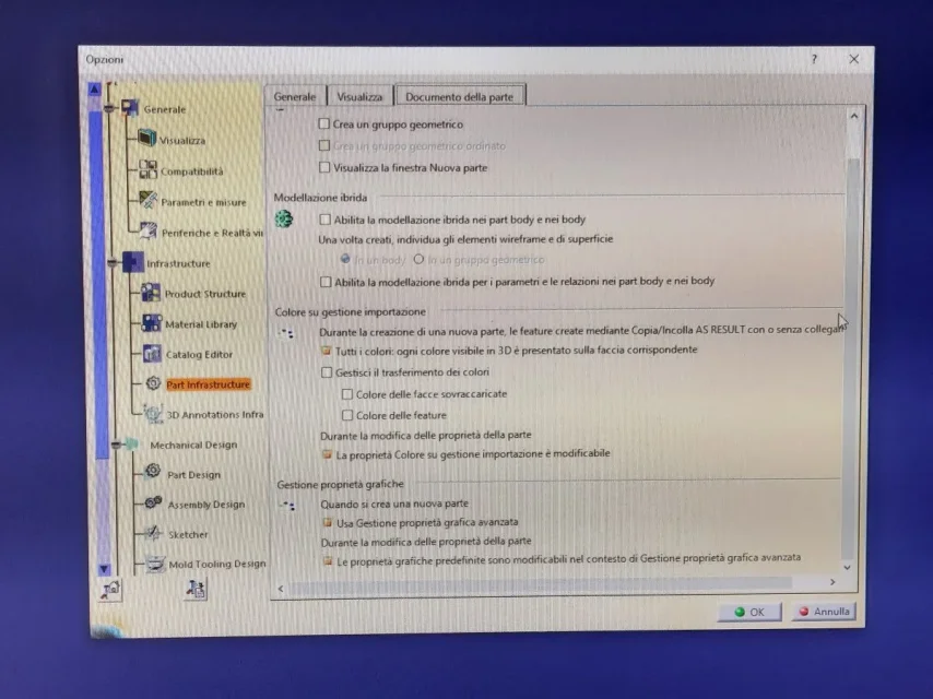

I have already tried to tick the voice: inherit colors of the reference feature, in the "part document" window, but without getting any results. if it can serve, I usually use r26.

hi andrea is a novelty that they have inserted from version 30 that I use, but perhaps already from the r29
open the part and on top of the tree you do property, go in the graphics/colors card I don't remember well and activate the voice all the entries
ciao @maste Thank you.
I tried as you say.. but it doesn't work,
I think there's a few other settings to set up in the options.
You think of anything else?
