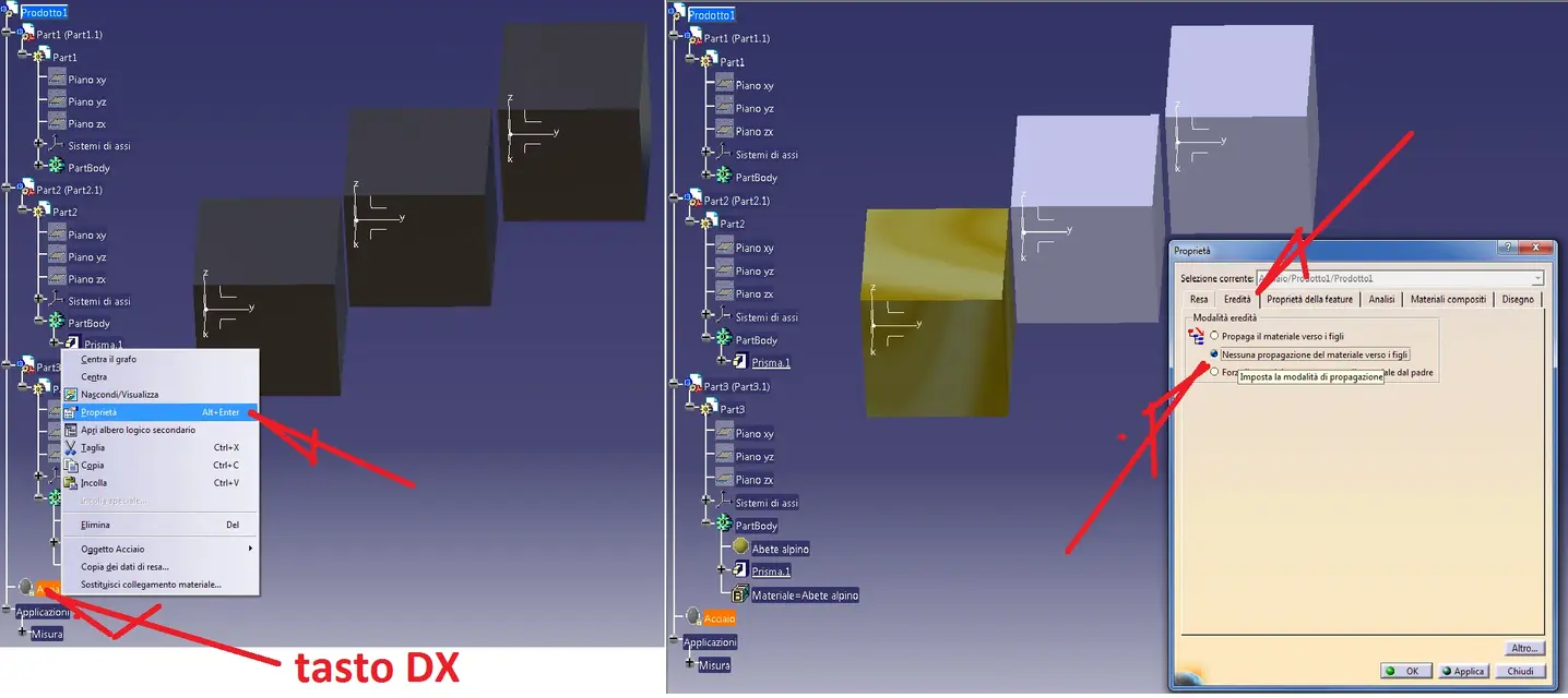

I cannot understand how I can stop the inheritance of a material applied to a product so that it is not applied to some part.
can you prevent the process of heredity without applying/specifying a new material?

It's true!! Those who have a head formed in an environment don't get to do things out of normal!! to me would never have thought of assigning a material at product level! .
However through the product properties you can access the material inheritance to the parts.
Clearly if I don't check materials even to other parts don't get the rendering of the parts (normally you assign the material to the part), so I don't know exactly what it can serve... can only be useful to estimate the weight of a set in case you want to replace the material.

Will you tell me how to remove the assigned material? seems that if assigned to product level you can no longer remove... at least I can't because in the context menu I don't have the "elimina" option.

strange to me works, either with the dx key on the material icon, which simply by selecting the material, and using the "canc" key from keyboard.

the catproduct to which you assigned the material is active when you delete?
have you pegged to install the carsettings again?
