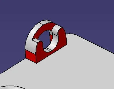

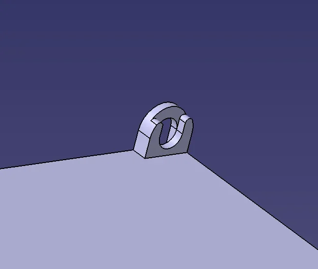

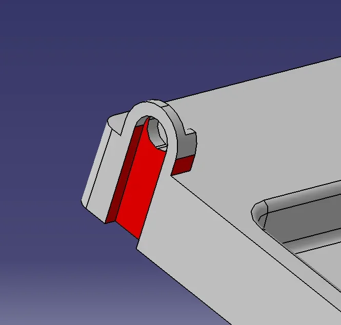

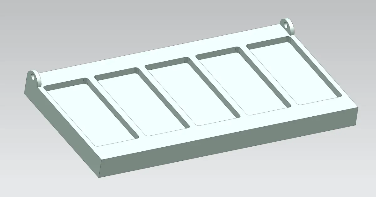

you can do what you ask.. without movement.Good morning, I am new in the injection molding environment and I would like to ask you an opinion/choice. in the piece that I attached there is a way to create the side holes (no need to be precise) without using movements ? thanks a thousand
