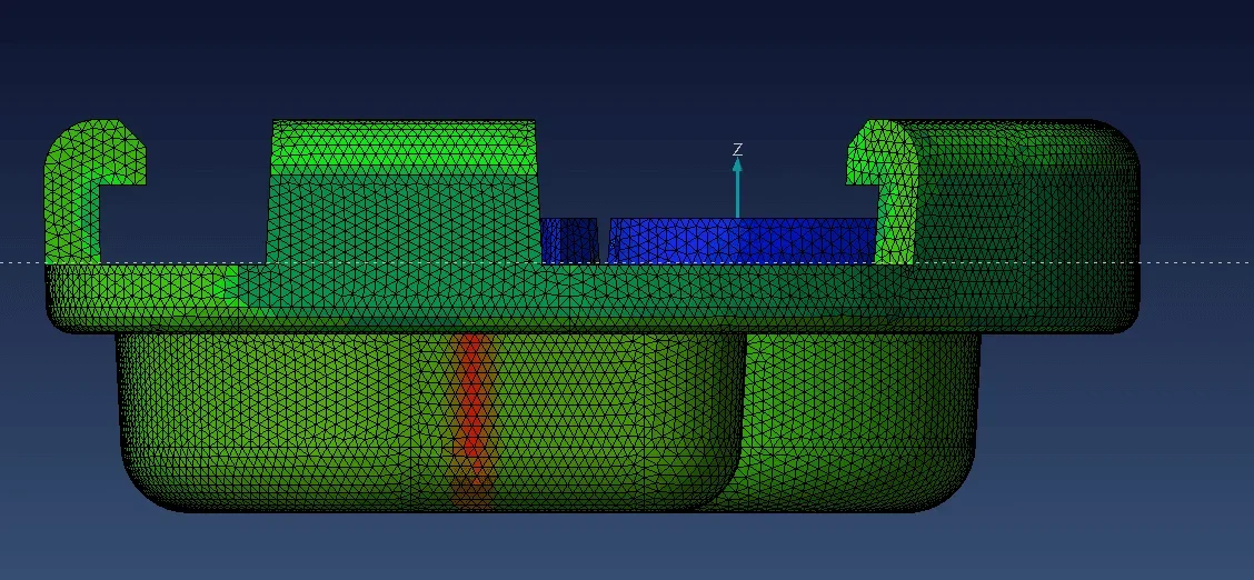

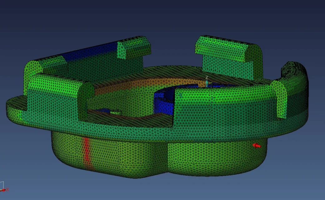

I do not know if it is the appropriate section, in case of negative response I will move the discussion to the right topics. I have to simulate the injection molding process of a component for a project at university. the component is that present in the attachments (I uploaded only the main views but obviously I have the cad file). for simulations we are using visi-flow software and we have explained the basic commands.
the first step I made was to run mesh on the component and already here I have a doubt: Once the mesh is done, we have been told to correct the calculation of the thicknesses running the software. doubt is related to the fact that I'm not sure what the software did. For example, the circle that is seen from the view from the bottom should not be there (if I have understood well how it calculates the thicknesses the program) because if the red circle should be there then a half arc should be present due to the semicircle that is seen from the view from the top.
the other great doubt that I have is the choice of the injection point, as I do not know where to place it since the first simulations I did (chosing as an injection point that shown in figure by the red arrow) did not show significant variations of parameters such as cutting effort, temperature, solidified sheath etc to vary the position of the injection point. where should the injection point be placed?
Thank you very much for the attention!

I can tell you that what you have chosen is the last place where I would inject such a particular, which is far from simple.
first of all with all those subsquadri the side of the tabs to l will be by force of things the mobile part of the mold, with its carts.
it goes by itself that the injection will be fixed, then on the top of the dome. depending on the aesthetic and mechanical needs of the piece you can have, perhaps, some options, but I would say that the most accurate injection will be placed on the flat part of the dome, more or less in the center.
hello technomodel! thanks for the answer! Can I ask why the point I choose is so wrong? for the not unidirectionality of the flow? then for the mold I'm not sure that I realized that you mean, we had thought to do so, taking cue from video of the tube where cover for smartphones were made: the mold for the side of the fixed dome, then two other parts of the mold (on the die side) instead mobile, so that you can manually extract the cover!
Injecting at that point would create very tortuous material flows and different lengths, moreover the flow front would be much longer than injecting at the center of the dome, increasing the problems arising from cooling of the front, junction lines, flow turbulence etc.
As far as the mold is concerned, you would hardly be able to extract a particular hand-made one. I'm evaluating to the eye not having size to give a precise judgment, but it seems to me to see that those fins have a consistent thickness, which would prevent him from flexing in order to extract the piece. In addition, such a molding would be uneconomic, requiring an operator to significantly increase the cost of the piece.
in addition to this, a set of things should be evaluated before being able to reason and set the mold. First of all, the material with which it would be printed, the finishing of the piece and then of the imprint, the annual production and the various batches of production, the tolerances required for the finished piece, any functional/esthetical constraints that prevent the placement of injection points and extractors in certain areas etc.

try to inject on the flat part of the dome, in my opinion at the center of the circular ribs you have below.
alternatively to the center of the piece. Of course, if you have no constraints.
the pe will not be flexible, or better, it will be according to the thickness.
but those hooks will tire to flet and return to position to block the due.

hi, the detail you represented in the image, so to the eye, it seems a little "thankful" to be injection molded. try to eliminate the subsquadri that you do in this way really complicate your life. I leave you a link where you can find ideas about it. (on the net there are many others, but the concepts are always the same)
the thickness of the particular must be uniform, the sforms are decisive for this. once created the detail by eliminating all "useless" subsquadri and having uniformed the thicknesses you can switch to the filling simulation phase.
to verify that the thicknesses are uniform do not need special software, do sections and observe .

injection point chapter:
if injected into the thickest part means that you will find the front of the material that has already partially cooled that has to fill the narrowest area, you will have an increase of pressure.
the area where it tells you to inject is not the best, but given the size of the piece you could get a good result the same.
on the fact that you have to use cold channels I don't see why you have to inject in the part below, you can well inject in the center of the dome by making cold channels, just make a mold with third plate and a small matezza that will feed the various footprints in the center of the dome.

for the injection point now I have a doubt: is it not recommended to inject where the thickness is greater (if possible) and so that the flow is as smooth and balanced as possible?
As for the mold, not being the goal of the course (there is another special course) we have not deepened so much, it was more a curiosity/doubt that we had me and my project partner (although a minimum obviously should be imagined how the mold should be, otherwise it would be possible to inject from any point).
first of all a piece that must be printed must have as uniform thickness as possible, so already for this your statement has not much foundation.
What do you mean by balanced flow? balances the straightness, or the hot channel, so you have uniformity between the various footprints. the flow that fills the piece would not consider it balanced, unless you have more injection points, in that case the flows must be equal to each other.
sisi the piece is better if it has uniform thicknesses definitely, but for example I think of the joystick of the playstation where some parts are less thick (for example near the analogues, I don't know if you have present) and I think that this pieces are injection molded. In other words, with thicker parts, I was referring to the fact of injecting where the thickness of the generic component is greater.
with balanced flow I mean that it follows a path as homogeneous as possible and that it does not have many direction changes (as little as possible).
here is precisely the departure that is wrong.... search the best point to feed a piece, without having the slightest idea of how to make the possible mold
I agree, though only partially.
I always play first of all on where it is possible to inject, evaluating the needs of the piece and the needs of the mold, then I try to reason on how to build the mold in order to inject at that point.
if it becomes impossible or very expensive I make a series of evaluations, even with the customer, and I go to look for an injection point that allows me an acceptable compromise between finished piece, mold cost, realization times etc.
Of course, the basis of all this is that it is necessary to know how to build it 'this blessed mold, if not to end to a mere simulation exercise that however does not lead to anything, in case the mold is not feasible.
the point here is that the piece as it is designed is not feasible, the subsquadra are on all 4 sides, in order to be able to print it, it is necessary to change the geometry in the subsquadra zones (create of the small openings in order to create small dowels in part fixed that crossing the piece go in mobile closure, creating the undersquadra teeth. This should be considered the production of 240.000 pieces a year, so at least 4 prints with hot chamber and 4 injection torpedoes. I wonder what criterion these people teach......(s)
