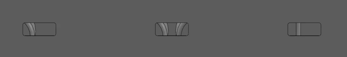

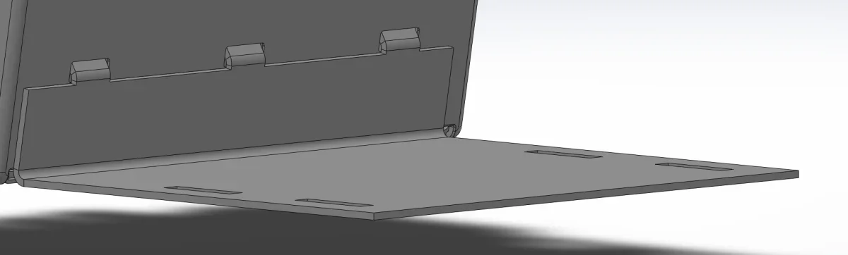

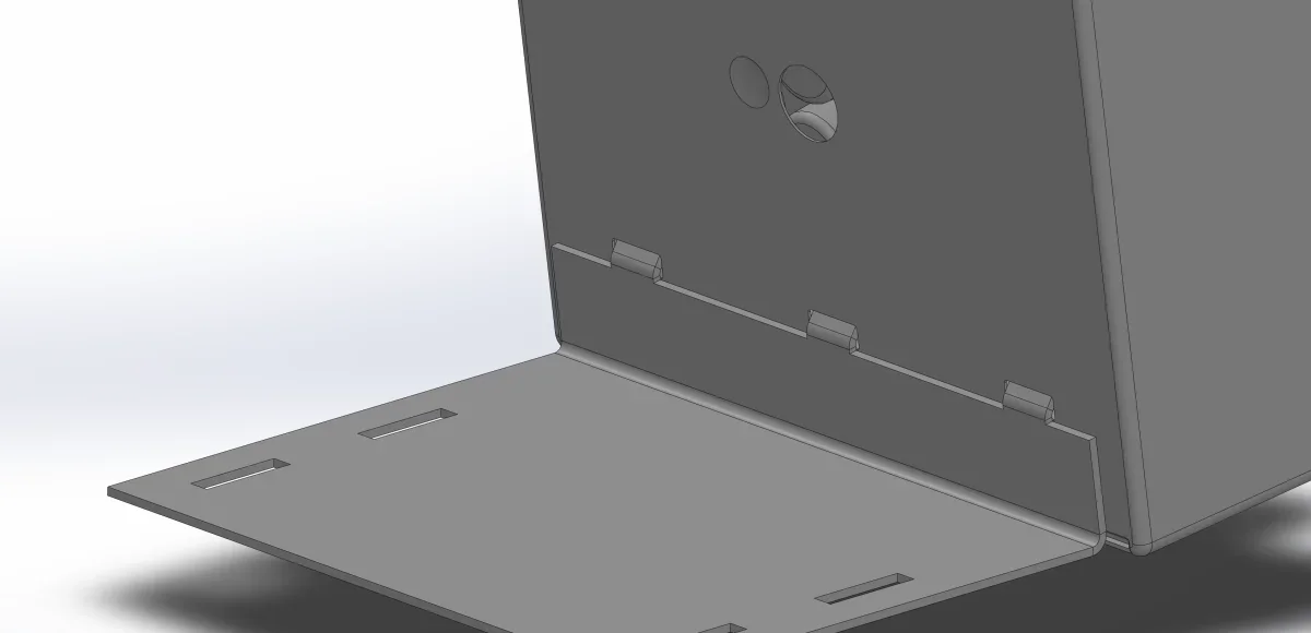

I would like to ask for your opinion / advice and maybe help on a piece that should be printed in injection.
I was sent this draft of the component, but in my experience I do not find it actually printable.
Can I ask you how you would intervene to fix the piece and actually make it printable?01.webp02.webp03.webpThank you very much.
attached for those who wished I attached a step.
Sorry, I saw the annex correct, I try to re-bind it.
the mold does not have to make many printed, however it must do at least 20000 printed.
the piece I have freedom to change it, the important thing is that it can be feasible.
to describe it in short, this is an element that needs to be placed on a shelf and the tabs that come out serve to hold hooked and tilted another component, the logic that I need functions is that this support has fins that go to frame and hold tilted a caddy. I attach a photo that I'm not sure I've explained best.

If the 4 rectangular wounds can be industrialized -> sformate, and created of the closing steps matrix/punzone inside them, you could place the particular rotated of about 10° so that the flank goes into extraction (remember the outer surface of the flank and the wings with the matrix, and the thickness revenues all in punch.

ciao @et3d , if you put the piece as you suggested @face You should have no problem. The loopholes on a thickness of 2 mm should not trouble you.
evaluate how to distort the walls highlighted in red (I have only highlighted two but the speech applies to all those similar), because it is not so simple.
currency:
- from which to put the extraction because the sign of the extractors could represent a problem.

et3d that piece is not printable is a sheet, in order to realize such a piece of the injection lacking ribs, and excavations to keep the piece straight, it is not recommended to print large flat surfaces. if that particular must bear the load it is necessary to rinse also the fins. As always my advice is to ask those who have to print the product, by now all printers offer co design service and feasible verification.

today by injection of plastic materials, you can get very complicated pieces, even with subsquadri as in this case.
Let us remember that these presses, move half of a mold horizontally then to eliminate the subsquadri, just tilt the figure as already mentioned, the extraction of the canals should be possible anyway.
another system that I think the moulder prefers, is to print the piece vertically, with an external part guided by two inclined columns that go to close the subsquadro in phase of injection, and free it in phase of extraction.
all is obtained in the mold, without external spins.
