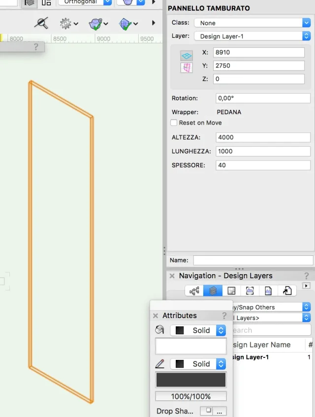

I'm trying to make simple parametric objects with handcuffs.
After many attempts and tutorials observed I have come to get a simple panel object where in the object information palette I can insert the value for height/thickness/length inserting them into the specific boxes.
to the object I associated a compiled record so that then, realizing a project and inserting the panel object with different sizes, I could get a report with a distinct that would list the number of panels used divided by size.
If this operation I do it using the box object I can get the result described above.
I would like to know how to change my object made with puppets so that I can find in the report the 3 dimensions length, thickness and height .

Hi, I start with the simplest question. Have you tried to create the report reported to your record?
Thank you very much for the answer.
I created the simple model above. once saved as an object I renamed it and applied a record.
if I go then to get a report I can get a calculation scheme where I see listed on the various columns the record entries that I edited and applied to the object. (for example my object wants to be a drum panel... the various entries of the record will be code, description, weight, cost.
once you get the report... I then go to change by inserting new columns to be able to have in a length, in a thickness, in the third height,
in my project I will have my panel declined several times with different measures, my need is to have a report that accounts me by dividing them by size.
I already got this result by making the panel object with a box. between my cataloging criteria, when I go to edit the report, I find the characteristics of the box object (x, y and z) that I can insert in the column of the report and he counts and divides the panels according to the different sizes.
However, wishing to realize the object in this way trying to get an object with multiple parameters, I have the problem that between the criteria to be selected to realize my report, I do not find those related to my specific object.
searching on the net I found that there are other knots to insert type set record field and pio handle. but I have not yet understood how and where to insert them.... .
I hope I've been clear. . .

Yes, I understand now. but I can't help you in this case because I'm not expert in puppets. On the contrary, I envy you a lot because you're doing a kind of work in which I found myself, but that I solved differently, precisely because incapable. your puppet object is much more "smart".
I suggest you ask on the American forum, there is a section dedicated to puppets.
kind lory.b
Your intervention was very useful... Your question, which at first seemed to have been for granted, made me understand where I was wrong. I did some empirical attempts and eventually found the hippo:
I had to insert the voices height, thickness and length in my starting record... I will then decide when to show them or when not in my report... setting the various criteria.. .
the American forum I asked him. . kindly they had also indicated me a post where you had already faced the theme... there I had found the suggestion to insert in knots set record field and pio handle... it was not specified but it was necessary to change the record... to read and read again I came out.
