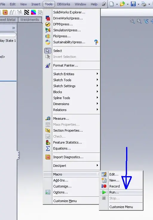

the macro is already ready, you just have to launch it:
activate the macro toolbar, click on the play icon, select the file, from the ok and open the window where you have to go to select your file content the xyz points.
even better do this:
right click the toolbar menu. customize/commands/macro and drag the "new macro barrel" button into the toolbar and exit with ok
when clicking on the new added button opens a mask in which you indicate the location of the macro file associated with that button, possibly a different icon and other options of the button, including the keyboard shortcut which is the most convenient solution.

Otherwise, an image is worth more than a thousand words.

You don't need to go copy any code. when you create the button you just need to choose to associate the "gen3dpointcloud.swp" file that you downloaded from the link we have shown you. That's the macro. point.
Similarly if you choose to simply click the Macro Run button then choose that file. :
I missed the link to download the macro... :biggrin: I thought the macro consisted of the page code... Now it works!:finger:
