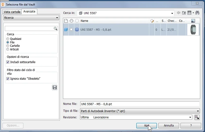

as always you have to be within a part and select the drift command
then you have to select the vault icon1633374333686.webpfrom the vault interface, you have to go to the content center1633374375459.webpselect the nut or screw etc...
the derived part is created in the .ipt corente file1633374409554.webpupdates the vault browser1633374426049.webpif you stop the link from the inventor's browser.. .1633374474083.webpwill cancel the connection in the vault browser
then you have to select the vault iconView attachment 63364from the vault interface, you have to go to the content centerView attachment 63365select the nut or screw etc...
the derived part is created in the .ipt corente fileView attachment 63366updates the vault browserView attachment 63367if you stop the link from the inventor's browser.. .View attachment 63368will cancel the connection in the vault browser

Hello, thank you for the answer.
yesterday then I arranged a bit and, although through another procedure, I managed to insert the part from the vault.

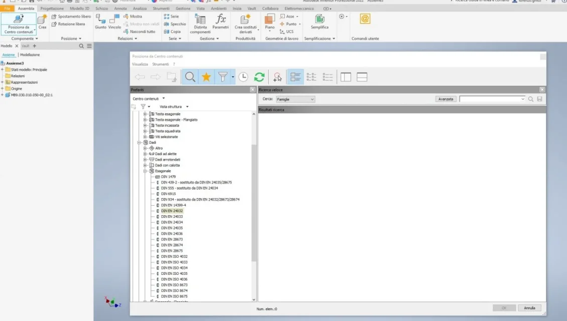

Other problem
If I use the command derives and select the vault icon, when I choose "center content" this table appears to me.centro contenuti.webpthis content center is not complete with everything.
In this case, however, in combination mode, if they place a part from the center contained, I see the complete table.assieme.webpWhy are there two different tables in the centre?

Could someone please tell me how to be able to bind a derivative part when inserted?
Sorry but I didn't understand, after loading the derivative part into the axieme, it's a part like the others, so it binds in the same way.
