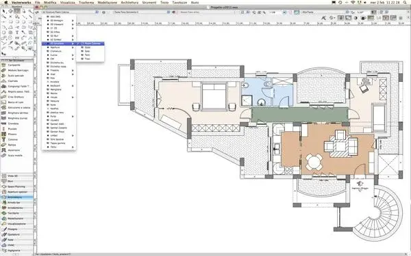

organizes the whole plant on a single gloss, if it develops on a single level. If they're more flat then you'll have a polish for each floor.
the right object to use is the pillar, which is a smart object and integrates with the walls.
I recommend you create a category "pillars" or "structure", however a special where to draw the pillars, which you can color, turn on or turn off at your liking.
the columns are instead of the objects a little more specific, perhaps also useless for those who deal with contemporary construction;-)
I do.
Hi, I agree with what lory.b recommended.
Remember, that the foundations of good work are based on the right and orderly organization of the "lucids" and "categories". the larger the project the more this organization must be refined.
I send you an image of a job I'm completing these days.
n.b. if you want advice and tips you can also register in the forum of the videocom only Italian distributor of vectorworks. here you will find the technicians and users (like me) ready to give you a hand....
