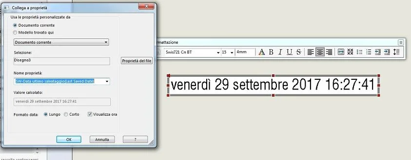

hi guys, I was wondering if it was possible to activate an automation that puts on the table the date of saving the file in dwg and/or pdf format: is it possible?
and do the same thing but by stinga type
$prpsheet:"sw-data creation(created date)" but specifying in the string that must be as short date and without now, is it possible?
I'd like to write it in the string.
if in the cartiglio you write $prpsheet:"sw-data creation(created date)" he returns you Thursday 18 July 2019 14:48:25
I would like to write a stinga that returns me the date of creation of the file but in format 18/07/2019 without putting spunte or things like simply writing $prpsheet:"sw-data creation(created date)" for example.
They are things that can be useful to everyone, it doesn't bother me to put or remove a tick, but if I had different needs maybe it can be useful.
Maybe someone who knows, on the net we are many and the needs are different.
