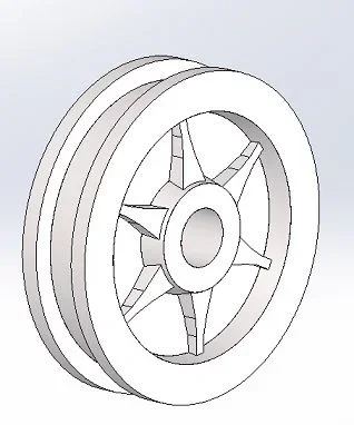

Hello I have problems interpreting those (I hypothesize that they are) breeds of pulley (and those two central vertical lines to the races what are they?) to model the piece in cad... what can help me? ?Screenshot_20180306-142430.webp

the exercise I have to carry out consists in the representation of the hub through top-down modeling: said that for the rules of the technical drawing the pulley races never occur (I have identified the part highlighted in red as a breed of pulley), if it is just races, then I can not understand what the part highlighted in yellow: to make it short I can't make a general idea of the piece to realize, what can help me?

and those two lines vertical central to the races what are they?
Let's go well, I'll give you some clarity on the terms: are horizontal and generous perpendicular to those you hypothesize to be races, but they are called ribs.
those lines could be rigging of ribbing, which you can only understand with a side view. I attach an image made in exemplary speedImmagine.webp

for me it's a normal pulley with stiffening ribs.
being particular that are normally made by fusion need corners of sform; that rastremazione is precisely a corner of disform as are the inclination of the inner diameter (even if you see little) and external of the lightening (the one where the rib is placed) of the pulley.

I would say it is not a pulley but a wheel with two lips for transport on track.
Surely the melting wheel will have ribs such as races and these are those that are seen not dissected.
Right. I focused on ribs looking very carefully at the rest of the design in which the shape of the track is evident
