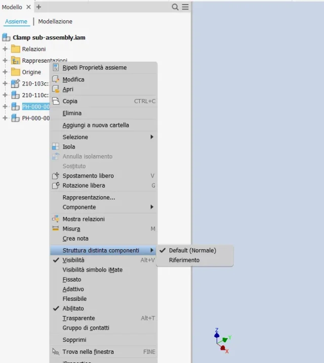

I have just passed to 2020 and frame generator gives me some problem: in i-properties the mass is nothing despite the members of the frame are steel. Has anyone had the same problem?
Laura
Hello laura,
test whether your "frame" subaxis is set to reference or default (normal). to obtain the weight of a component/assieme the "different component structure" must be set to default (normal).
to verify this you do dx mouse on the subassieme then select "different structure components".
