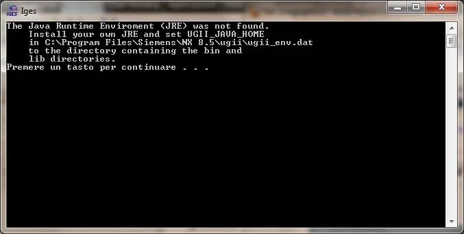

Hello everyone, since yesterday I have a problem with nx batch translators updated at 8.5.1, java is 7u13.
practically with any batch I make, whether iges, step or whatever else I always have the same result:
errore nel batch.webpthe ugii_env.dat file reports:

I tried without positive result to change in:
#if x64wnt
#if file c:\programmi\java\jre7x64
ugii_java_home=c:\programmi\java\jre7x64
#endif
#else
#if file c:\program files (x86)\javasoft\jre7
ugii_java_home=c:\program files (x86)\javasoft\jre7
#endif
#endif
I don't know why this error started, it's a bit that I don't use the batch and meanwhile I updated java and nx from 8.5 to 8.5.1, do you have any solutions?

thanks for the tip baskets, however it did not work, with the dat files of nx I lost. On the other hand I corrected batch cmd files and now it works everything, I added the famous set strings in cmd and everything started to work:

However I would like to know why I don't work correctly variables in ugii_env_ug.dat.. .
Hello, Lorenzo.
I think I figured out why the mistake was wrong. I had not read your initial post carefully in which you said about the batch translator. It doesn't work because it's as if you 'high' the nx configuration that is activated when you start it but not when you start a batch command. to have the test confirmation to put the variables in the nozzle_env.dat (and not in the nozzle_env_ug.dat) in the location I suggested, launch nx and then go to see the log file (in help) and you will see that the variables are correctly set.
I recommend, at this point, to put these variables directly as system variables.
Bye-bye soon
I tried to put them in the ugii_env.dat as you suggested, but the variables in the log file in the section ugii_env.dat have turned out with the blank field. then I put them in the system as you suggested, in this way the batches work correctly and the variables appear correctly assigned in the system variable log section and appear double in the section ugii_env.dat.
Thank you. :biggrin:
if in the path there are spaces, then when you put the variable in the env.dat you have to enclose it between the double apici : ugii_java_home="c:\program files\java\jre7"
thanks ciciu, this was precisely the problem, in the _env.dat the path with spaces edited in the variables should be enclosed between the double apici. now I have removed the variables from the system, I have inserted them with double apex in the ugii_env.dat and I have cleaned from the previous changes the batch *.cmd. everything neat and working. thank you all and we hope you no longer understand anything for at least another year. :biggrin:
