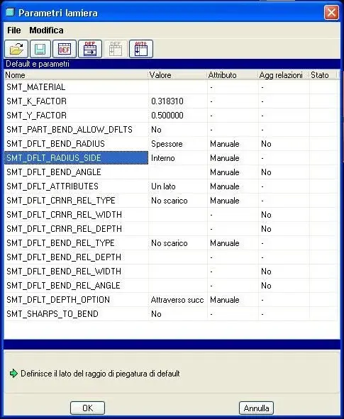

because by default proe has the bending radius of the sheet set on inside and instead I use always external, I wanted to ask if you know how to tell me what the key is? :finger:
I slew a little but nothing
bye, with wf2:
change > plate > parameters
then save the changes (the file is saved in the dir work).
