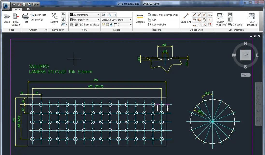

hello to everyone, I can't make this part with inventor 2013. In particular, I can't make the "bombs". Could you please help me? I attach an image of what I have to do.. .

Unfortunately, sheet metal stamping processes cannot be realized. . or better, you can make them with the use of processing a little at a time or with some punches molded ad hoc.... but then the development of the flat model is not "flat", but modeled.
thank you for the answer. In fact, if I try to do flat-model processing, then I don't represent them in the folded model. so to make a table like the attached image I should create 2 files; a 3d model to be inserted together and a flat model to represent the explanation at the table. correct?
ni... in the sense that if you hand models yes, but if you make the punch no.
Unfortunately, I don't have time to explain to you how to create a punch, but if you're looking for a "sheet punch" or "ifeature" guide, you should get there. If you create a punch you can, in the sheet style settings, decide how the punch will be represented in the flat model, so that you will have the molded folded sheet and the flat model with the only "sagoma" 2d or the shape + the center of the punch. . .
