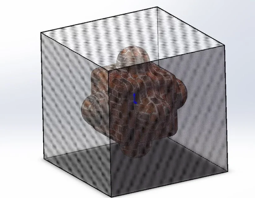

hello to all I wanted to ask you how do you do when you have to use square-line plates? maybe even bent to make carter
applied a texture? but so I guess you don't see through
create a light configuration with only development and then apply holes? and also here how do you quickly apply the perforated grid?
I would make a "light" configuration without holes to be used in the assemblies, perhaps with a plot material and default configuration use for developments and table setting.
then always depends on what your needs are............ .
I made a bookcase slot that applies some square hole to the sheet, selecting top and two edges for reference.

sincerely I did not understand the advantage of meccanimg method compared to drawing a square and making repeats along the x and y, but I probably did not understand what it means

the final result is some network hole a little chessboard. with three clicks you did, while if you model the whole you by hand it takes more time and if you have to do it everything becomes too heavy the file.
