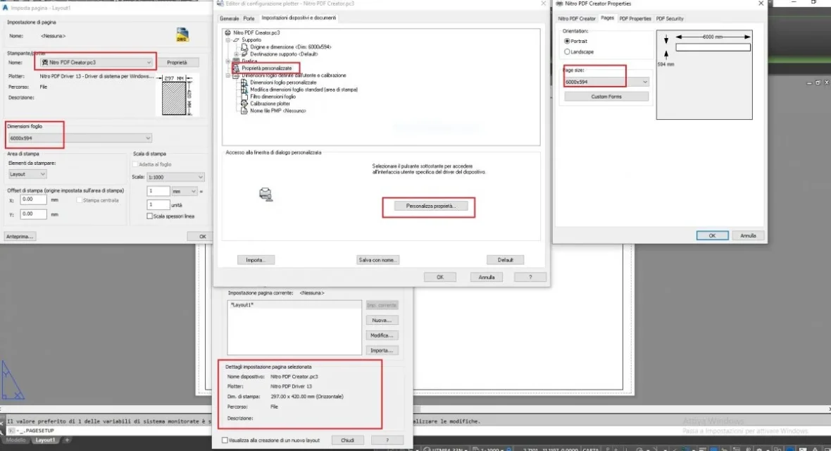

hi rpor66, I followed your directions but once confirmed with "ok", the layout always remains an a4 or an a3, I will show you the screen with the steps:2.webpin the last window below you can see that once confirmed, the size is not respected...and I don't understand why...I've never had any kind of problem with any type of formats, but now that I need a sheet over 5000mm is becoming a problem with these virtual printers.

I tried to select it but it does not seem to work, it always remains in a4 or other formats already prepared:2.webp
3.webpI can't understand where I'm wrong.

hi rpor66, thank you for the file I tried to copy in the indicated folder but nothing, the size always stays those standard...I also noticed that in the "pages" tab of the "custom settings" of the nitro printer, there is no possibility to insert the margins, maybe that's why you don't recognize the sheet since they are not set? I don't know what to think

with pdffactory I partially solved, that is I tried with a sheet of 594x6500 and made me create and print. If I open the pdf with "pdffactory", I can see it in the real size, if I open it with acrobat adobe stops at 5080mm and does not show me the design, then white sheet.
I then noticed that if I want to add a new layout, i.e. change size and make it bigger, type 8000mm, create the profile but then puts me a sheet from 1946mm long, so to pleasure, as in photo:
4.webpWith regard to the solution in multiple sheets in a3 I can not, it is a profile of a conduct from 6km in scale 1:1000, then 6 meters of table, to the maximum if I do not find a satisfactory solution, I break the table in two from 3mt... I wanted to avoid to do not remake the fakings of the legend/values. . .
