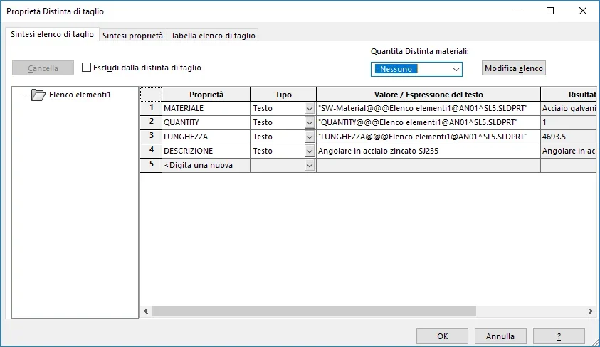

Eureka!
Thank you Massivonweizen!
I'm suing here what I did in case someone ran into this situation.
created the part, in functions I created welding.
in the modeling tree is created the knot "different cutting". inside there is a "elements list" folder that contains the solid bodies that will be considered in the cutting table.
clicking the dx button and selecting properties opens the separate cutting property table.
in my case lacked the property length, which I added in the property column by selecting it from the drop down menu.
for the expression I did not only copy that of the row quantity and replace to quantity, length.
Everything comes back.
