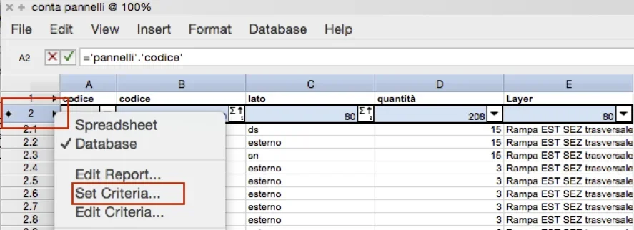

Good morning.
I would like to know if it is possible to have an electronic sheet connected to each polish?
example: gloss 1 with my electronic sheet with various information
gloss 2 other electronic sheet with other different information
or have the same tab and same electronic sheet that changes information to me according to the gloss on which I am? Is it possible?
Yes it is possible.
you can filter the information of the electronic sheet according to the gloss.
you have to right-click on the left cell with the rhombus. a context menu will appear to you.
This way you can edit the information display criteria.
