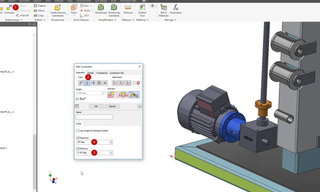

hi to everyone, I'm new on the forum, so don't want me if I'm wrong category or anything.. .
My problem is how to limit to 90° the rotation of a subset, around another one under axis. . .
using the corner constraint, solve the problem.
you can also manage the race, example 0°-90°
Check out this screenshot:2019-02-27 14_30_08-Autodesk Inventor 2018 - [8792 - IP ass. - 002].webp

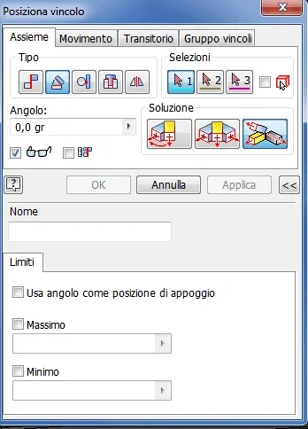

hello matteo, in the meantime thank you for the answer.. .
Here, looking at your screenshot, I could say that my problem would be to rotate the engine along with the gearbox, around the endless screw, obviously thinking about it as a smooth cylinder; the max angle that must be able to perform the motor and gearbox is 45°
