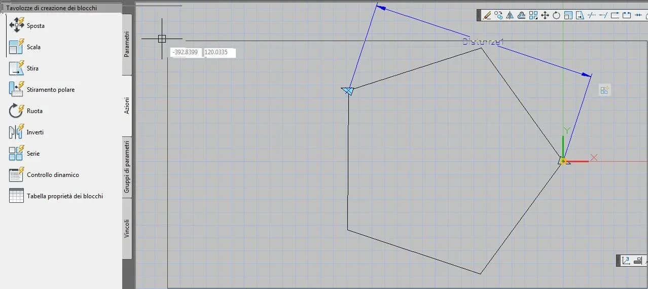

I'm trying to set a block by assigning a linear series parameter. autocad 2013
design the shape
I create the block
Published the block
block creation palette - parameter group - linear series
specific initial point - final point
right clik on icon series ( 3 squares / triangle yellow exclamation point )
Action selection group - new selection group
select object + sending
save block
close editor blocks
I get this:

the "linear series" you used in the first case, by default, set the 'offset column' property of the action series to 1.
In the second case, you are explicitly asked: "Digit the distance between columns (|||||):"
If you regain the crate block in the first case, select the icon of the series and then edit the properties (owners panel) change the value 'offset columns' from 1 to the right distance and you will see that it will go ok.

selecting the icon of the series the only properties (model property) to which I have access are: type - linear / number of grip - 1 / actions - series
if instead I make right clik on the 4 square icon with lightning the property voice is not there.
probably do not select the right icon.....
any other indication?
first of all type on the command line. should appear the panel of the offspring.
Thank you for your patience!! it was hard but the result arrived, very slender but arrived.
