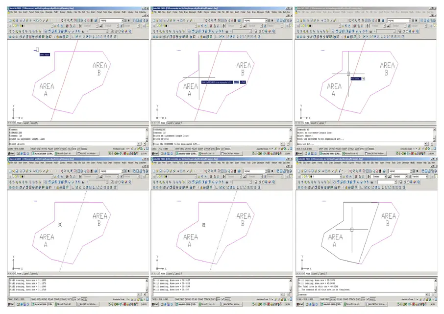

I do not remember from where, I arrived this lisp, very nice as it allows, once inserted a line of direction on an area composed of closed lines, to choose the value of the area of a part of the surface and to get this value automatically moving the line of direction.
Since it is easier to see than to say, I place the image with the explanation.
Unfortunately in my 2010 64-bit autocad the lisp stops, we say so, to the third image, and gives me a series of errors.
Would someone you'd like to take a look at the list and see where the trouble is?
or could you direct me to another lisp that does the same thing? online there are different, but... or not well (they give mistakes or do wrong operations) or, like the famous splitarea.vlx, they work in trial version.
Thank you. .
Bye! the version is in Italian and the errors, after entering the value in "area per lot", are:
command unknown "point". press f1 for the guide.
unknown command "-boundary". press f1 for the guide.
unknown command "or". press f1 for the guide.
unknown command "p". press f1 for the guide.
unknown command "as". press f1 for the guide.
the selected object does not have an area
unknown command "erase". press f1 for the guide.
unknown command "move". press f1 for the guide.
<gruppo 251="" :="" di="" selezione="">*nothing*
Yet I do everything that requires the lisp, I do not use polylinee closed, I use an xline as direction, etc.
uff!</gruppo>
