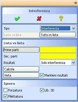

But once set, I believe that with the interference command, by selecting all parts of a group together in the list of the first parts and in the list of the second ones, you can find a list, which can be saved as text files, of all the forcings or interferences present.
in your case you probably just have to remove the flag from forced ignorance.
Finally also in annotation in the mode of calculation view (graphic, shaded etc) at the bottom there is the box marked forcings, so in your case it should be flagged and you should appear the list of details affected by the forcing.
