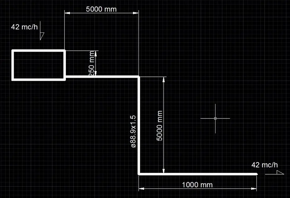

I am not very hard in hydraulics and I ask you something: in the attached design you see a bathtub where 42 mc/h of water enter. from the tub comes a tube (with 250 mm swing) that goes in a giant vasque ... now according to my calculations (using hazen-william) I would need at least 230 mm of swing because the ø88.9x1.5 tube is enough.
Does it seem correct?

But I don't understand the problem with your question.
What do you need to optimize?
Why do you "brutally" two curves at 90°? Can't you go straight?
Does the water have to go from above down or with a pump is pushed backwards?
then, according to my first calculations (powering from above down):
- capacity 700 l/min
- inside tube 88.9 mm
- geometric features as highlighted by you
- concentrated load losses: 2 curves at 90°
- no filter
- no check valve
- plastic pipes
- water temperature 20°c
results
fluid speed in the duct: 2.35 m/sec
concentrated load losses 0.07 bar
distributed load losses 0.09 bar
no curves must remain. I have to understand if it is better to put a tube of 4" (which from the accounts I made asks me 80 mm of swing) or if I can keep the tube of 3" (which instead wants 230 mm of swing)

However basically what I try to get is not to find water coming out of the mountain tub because the pipe fails to dispose of the flow.
0.16 bar?! of loss ... need a beating of 1.6 m?
load losses can be considered both in terms of pressure and in meters of water column (mca).
attention that are not meters...the mca indicate the Press 1 meter high water column.
1 mca = 9806 pa = 0.09806 bar

i.e. if I have load losses of 0.16 bar means I have to have a tank with height 1.6 m. of water swing.... right?

I attach my "solution"
attention: are calculations drawn down quickly between one thing and the other at work. I look forward to your opinions/recommendations.
the result is to have a diameter of ø65mm otherwise the flow to the valley tank would be excessive.
