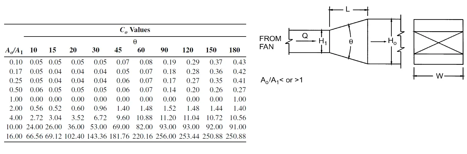

I attach the values of the coefficients of the load losses of the rectangular tubes that shrink or expand are in a dimension.
the formula that governs is as follows:
y = c0*0.5*ro*v0^2 where
y = concentrated load losses [Pa]c0 = adimensional coefficient related to the output section
v0 = output section speed [m/s]ro = fluid density [kg/m^3]if you want to use the input section you will have the following conversion:
ci = c0*v0^2/vi^2 where
vi = speed referring to the input section [m/s]pay attention to the ratio of areas to understand whether it is a divergent or a concentrate and choose the correct value of c0.

what I meant was a section reduction in one dimension, for example a rectangular section that sees only the height but not the width or only the width but not the height.

Hello mechanicalmg!
interesting your link; As for a single-dimensional enlargement I also have something but unfortunately I never managed to find anything on a monodirectional shrinkage.
the formulations you refer to a monodirectional enlargement though? .In the images is only the case.
I believe that then I will reason on the gradual monodirectional enlargement to have a reference limit value, then, knowing that narrowing causes less energy losses of an enlargement I will exploit the typical trends of enlargements and two-dimensional narrowings of section to understand in principle how to scale the value of a monodirectional enlargement to the case of monodirectional shrinkage.

the values I posted before you are both x enlargement and shrinking. Just look at the relationships between areas if greater or less than one. are ashrae boards, American regulatory body of the fluid sector etc.
Don't be fooled by the box.
I traveled both ways: first my associative reasoning reporting trends and bonds between load losses for bidirectional accidentality to the unidirectional case starting from the worst case as an accidentality up to the one I wanted... then I used the table of mechanics...the results are quite similar and...the satisfaction really so much:).
