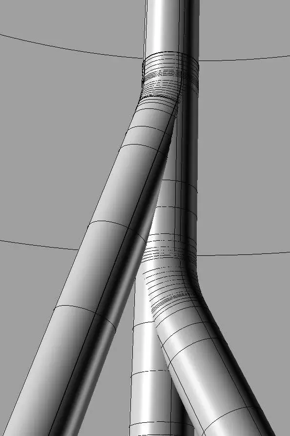

Imagine 3 tubes starting from different points (at 120°) and join in one tube.
Kind of like the highway entrance lanes.
the diameter of the tube is constant always, both in all 3 tubes and from the beginning to the end of each tube.
in the last stretch they overlap obviously.
I used the seep1rail command.
I can't delete 2 of the 3 overlapping surfaces in the last stretch.
If the diameters were different, I would keep the diameter greater and with the command "tronca" or "southdivid" I would eliminate the missing parts.
But it makes me mistake, how can I do it?
I think you can't erase them because it created you a single tube surface
if you want to combine them with the intersection curves, use those to trim the various surfaces and then reunite the whole

the command to obtain intersection curves between 2 surfaces is _intersect.
I suggest you process 2 tubes at a time, not all together. :smile:
you should get the one shown in the image and contained in the attached file
