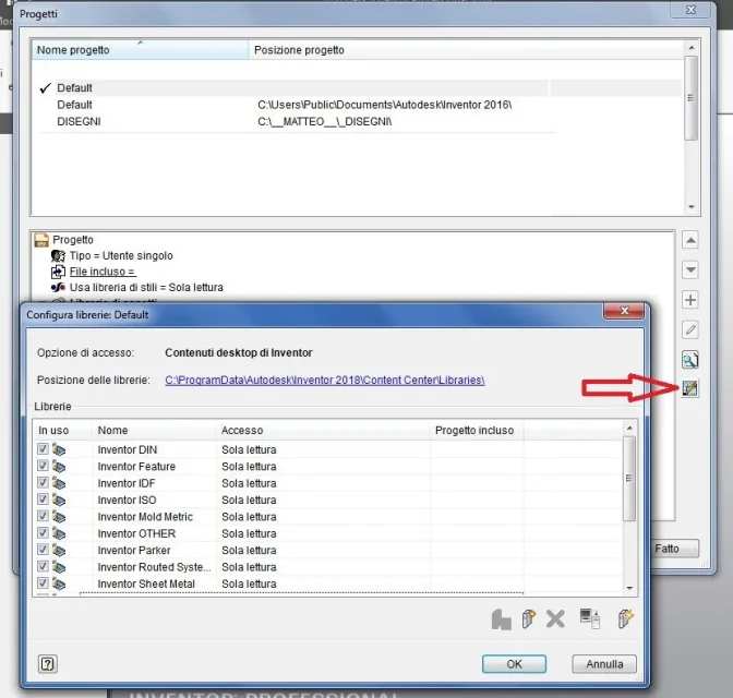

after the update to inventor 2018,
I completely lost all the elements of the contained center and the window turns out completely empty.
I assume that the program points to a folder or incorrect file, but strange that default does so,
both in the 2016 update and 2017 did not give me this problem;
Moreover, the strangest thing about all is that my colleague works perfectly.
Has anyone happened?
I messed up with project management, or is it better if I compare with assistance?
I have happened several times that, if, during installation the antivurus is active, the center files contained are not installed
a solution I have adopted + times (works) is to make copy-paste of files from the pc of the colleague to the folder of your pc
to see the exact path of files
menu begins, projects
