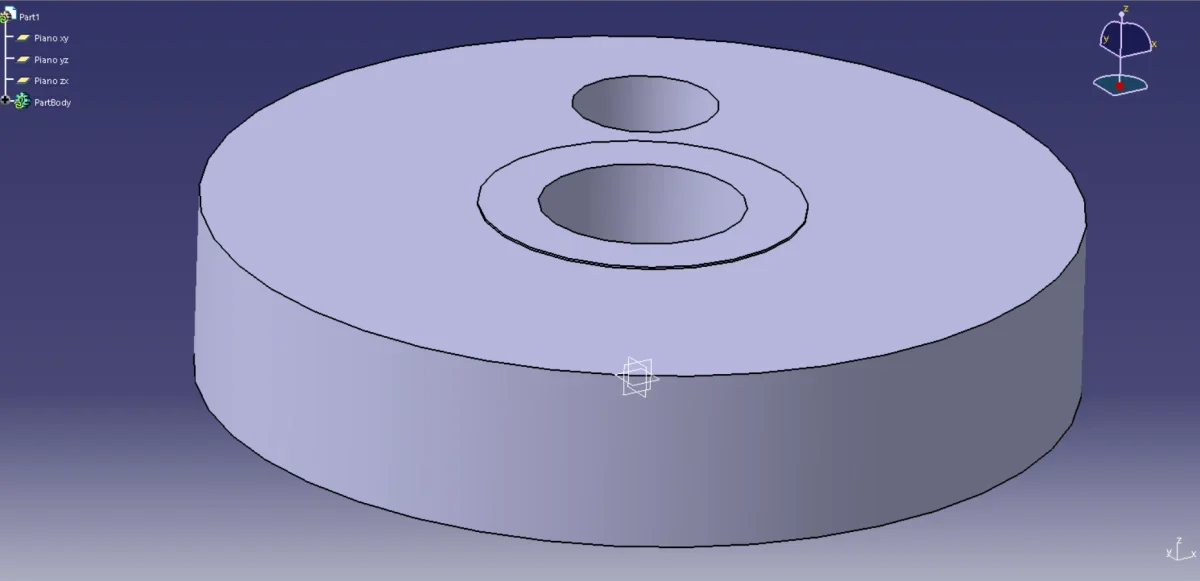

It's a few days that I'm banging my head without coming to the head. Since I often need to perform the solid feature that you see in the image below on various holes, I was thinking of creating a macro that automated this process.

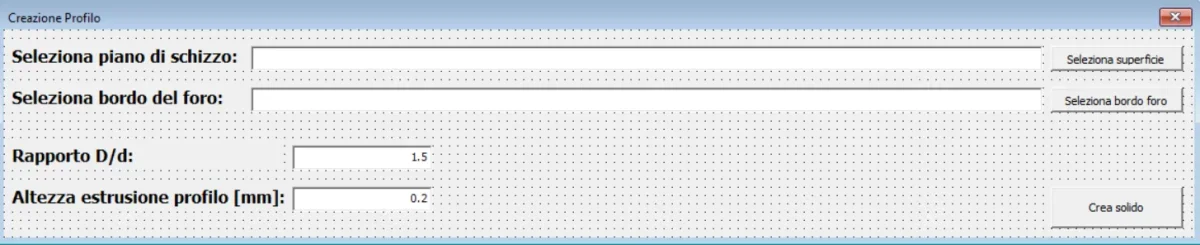

the solid feature to build is a "prism" that has as a basic sketch the projection of a hole and a larger circle that has a diameter n times greater than that projected (n parameter to set). extrusion height is also a parameter.1679646998897.pngto do this, I created a userform that you can see in the figure below. the user must use the 3 buttons in sequence (ground selection, select hole edge, create solid) and the two text boxes of the d/d ratio and the profile extrusion height.1679647499974.pngI admit I know quite well the vba programming on excel, but they are really at first with catia. at the moment what I did is the following:

at this point, in the longer text boxes the name(?) of the selected surface and edge appears. pressing "crea solid" I would like the software to build:
1. a sketch plan on the selected surface (using the name in the userform? )
2. from the edge of the selected hole derives the diameter and its center
3. takes the edge of the hole and projects it on that floor
4. creates a new circle with the same center of the projected edge and diameter d=n*d
5. comes out of the sketch
6. extrude height set in userform
7. uncheck everything and cleans all userform for a new operation

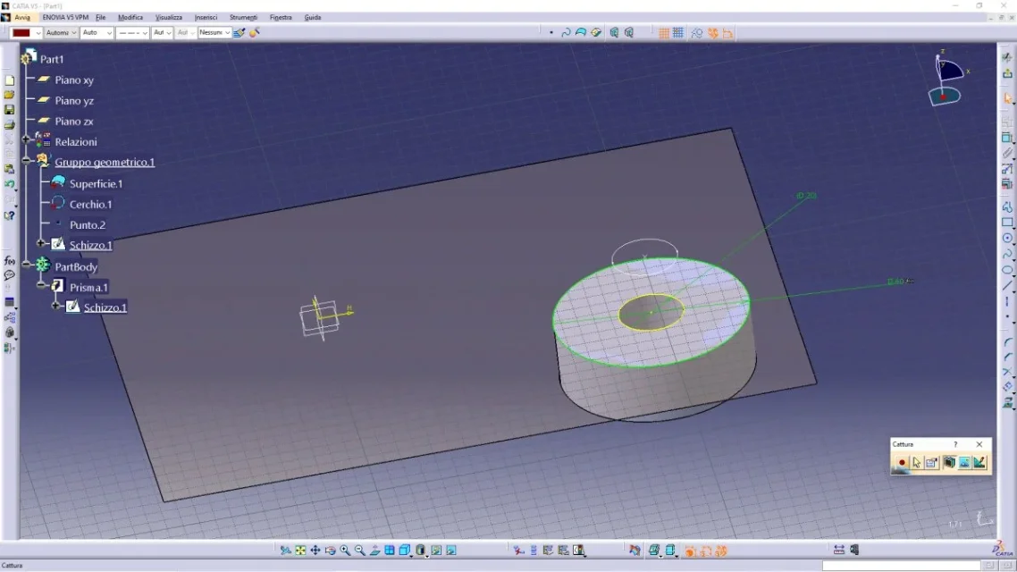

I can't help you in programming, but to achieve prism as you wish, one of the possible ways is this:
1) you have surface
2) you have the diameter (in this case higher than the surface)
3) revenues the center of the diameter (features point/type of point/circle. ..centre
4) create the sketch using as floor the surface
5) inside the sketch project the circle (menu/insert/operation/geometria 3d/project elements 3d
6) put a constraint to the diameter (it will give you a reference quota in parentheses)
7) Projects in construction mode the point
8) use the point to build the outer diameter
9) impose the constraint of the diameter and change the formula (right/modify the formula, select the quota of the constraint and multiply for value n
10) get out of the sketch and generate prisma
from the formulas revenues the names necessary to set the programming
Let me know.

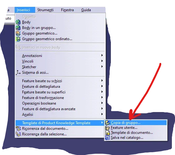

quoted by catia guide:
a group copy consists of a series of features (geographical elements, formulas, constraints and so on) that are grouped to be used in a different context. they can be completely redefined when they are glued.
group copy captures the design intent and know-how of the designer, allowing for greater reuse and efficiency.
practically perform a series of modeling operations that then reuse by simply changing some data of impt
