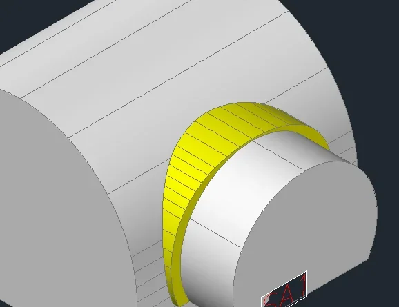

make 3d collar
  • Thread starter Thread starter jim78b
jim78b
because I can't ask more experts.
I should do as in the flooded file :gluing, is highlighted by arrows.
I tried them all but I don't understand cm and make sure that it follows the 2 galleries then the section varies continuously.
I also attached the dwg file with what I did but I just can't straighten it to make it look like that of the image
with what logic the collar combines the two surfaces?
why in the first image above is zero and in half gallery picoola is wide? What happens under the gallery? I think it disappears. .
with which angle attack the two surfaces?

the dwg file with the model is attached.The yellow tunnel intersects at 90° in the gray .in fact I made a subrait to the yellow one to give it the form it has now but I do not understand how to get a "glue" as in the first image.
under the gallery ends is that disappears is a kind of collar that fits above.
that there is the file attached with the wrong sulotion I understood.
What I don't understand is what the correct solution is. a collar has the same thickness everywhere, and it is not a simple small gallery r wholesale.

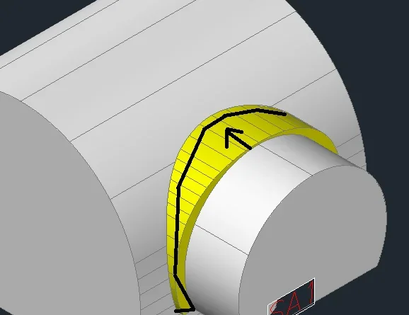

the correct solution from which I would like to copy is the first image.I indicated it with an arrow.
I don't care about the angle they attack, but better to start with 90° is easier I think.
I want the 3d because I would be interested in the procedure
I didn't mean the angle of attack between the two galleries. I meant the attack angle between the collar and the tunnel.

the angle does not exist, in the sense that the yellow collar I want to rake it until touching the gallery on which it interfaces from the first figure is clear.
as if I make a projection of the yellow part until you get to the gray tunnel. Maybe if you want it will be 45°.collare mio2.webpI have brutally sketched what I meanthe collar must cover the tunnel with sa1 and the one on which it intersects (see example first figure)

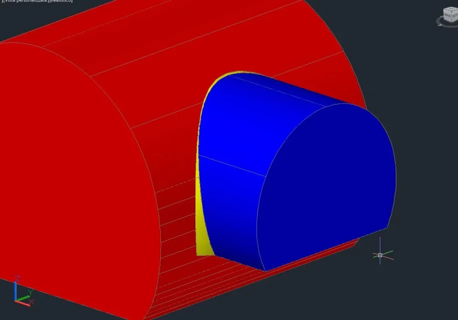

The yellow collar is fine as I did, but so they don't select the collar when I make interference?
View attachment 49456hang out the 2 galleries (empty inside) and then interfer
thank you now it is clear.a thing that makes it difficult is that my yellow collar does not have a thickness always equal from how you see .cmq on your model x give the form that I mean I should then smooth the edges and the game would be done.
One thing... the yellow collar after the gate?
You mean something like that?
has been done to the eye in 10 minutes, with the right measures should take on a more proportionate aspect
