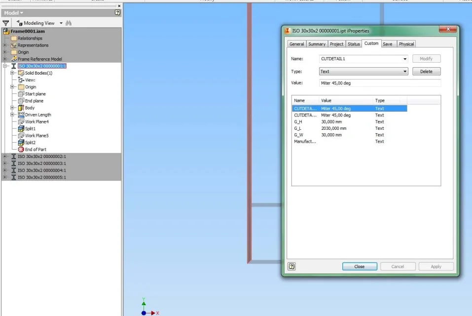

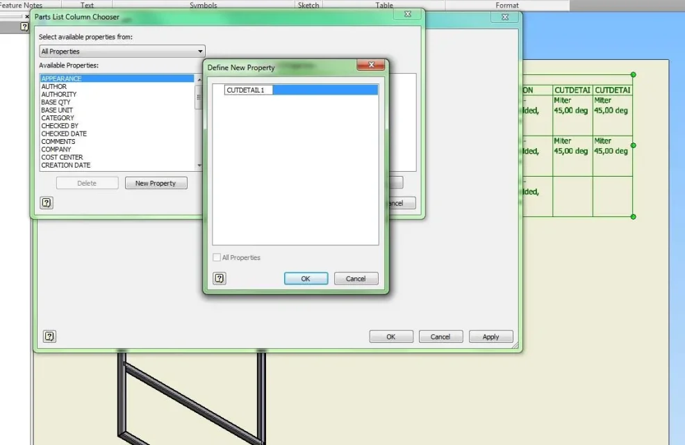

something to make a table of cuts of profiles of a frame with lengths tube cutters fourth and similar? If I'm not mistaken by creating iparts and modifying the visible columns in the particular list on the table you should do, only that it is so boring and far to set as a procedure that I strongly hope someone has a better solution (write it in the description does not apply)
if they are parts made with the frame generator it gets fast
there is already the set cut parameter, so just add it to the component list parameters
the parameter name can be found under the model iproprietiescut detail in model.webpin the example are "cutdetail1" and "cutdetail2"
then when you go to insert into the table the list of parts modifies the table by adding a new itemadd custom prop.webpso you find the degrees of cuts in the cartpart list with cuts.webpthis is for the 2014 version (without modifying anything of the standard templates), for 2015 I have no idea I have not yet made the pass

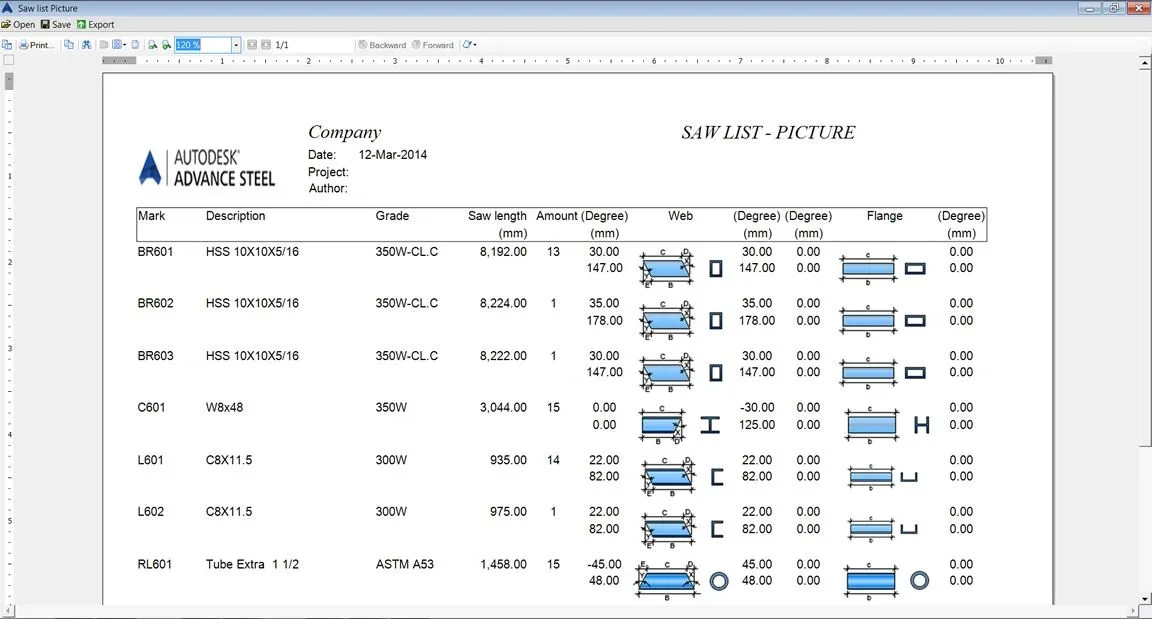

I don't know if other modelers similar to inventor have these functions; but it seems to me functions of some programs
specific for metal carpentry structures, which generate normals where you see the beam and its cuts of ends
as tarkus says one of the few software capable of doing something like what you ask is advance steel, which does this.
the only parametric software, (similar to inventor), that can do just as I think it is created with the afx module.
