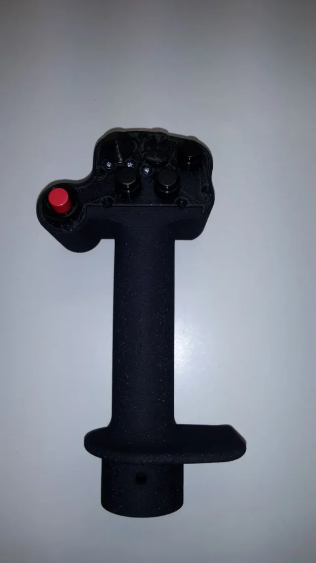

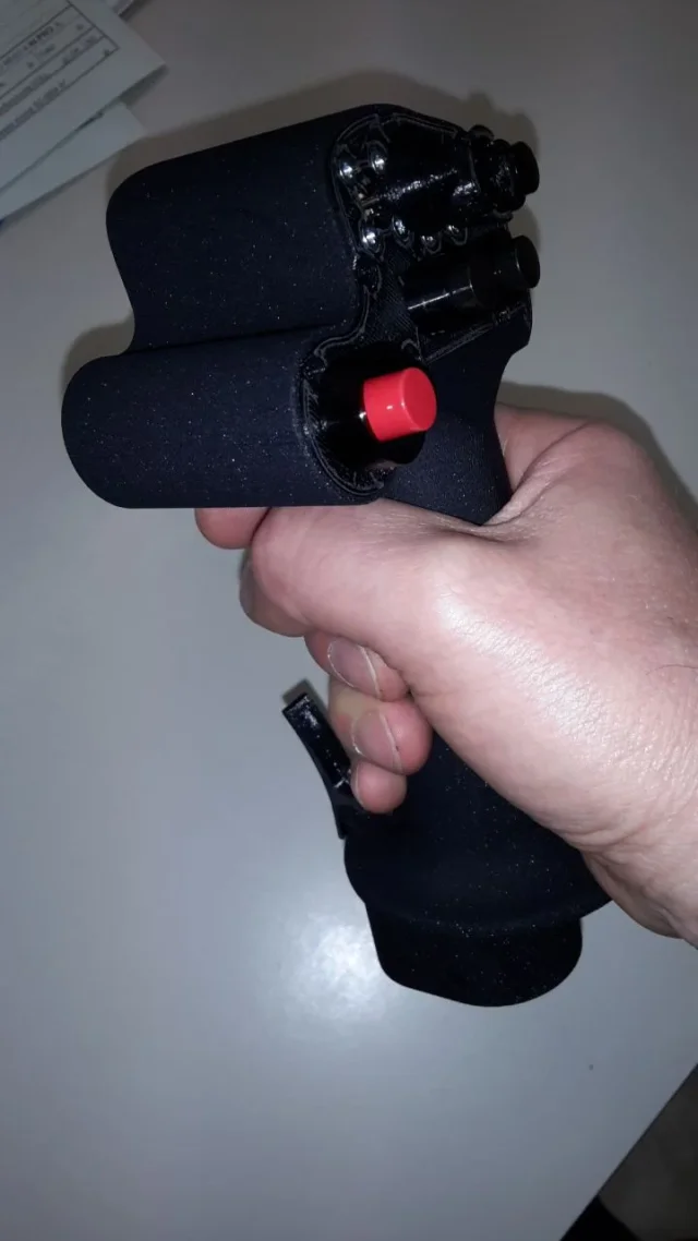

a completeness of the work arrived the joystick printed in 3d. here are some photos:
20170427_120217.webp 20170427_120229.webpthanks for the help and advice!!!:finger::finger:
