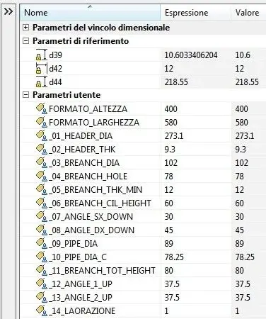

and can vary the user paremeters value of parametric quotas through a macro vba?

Do a for each one... next for each institution of the model space, when you point the quota block the execution and see in the variable window what its properties are.
