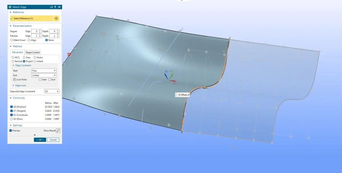

Hello girls, I was doing exercises with the "match edge" but it doesn't work, in image I have two 5th grade single span surfaces, I can't give continuity g1 and g2 within tolerances, what am I wrong?

Hello, girl.
uses the "normal" movement that leaves the free poles to move freely.
also controls that the surfaces (in fact, the surface that goes into the match) have enough in u/v to be able to mate with the reference one.
also attentive to the exact match...
