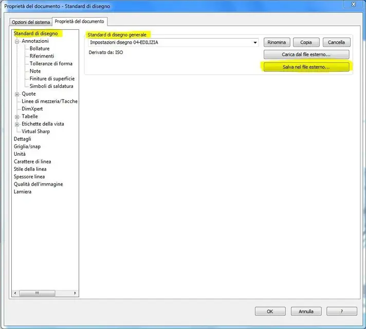

create a tamplate with the options that best hold you, or save the various settings in "general design standard" that you can call back whenever you want.
for example I use different settings according to what I put on the table, for example the design of a railing will have a style quotas and lines very different from the design of a sheet carter, all always with the same design template.
I attach images for clarity.
