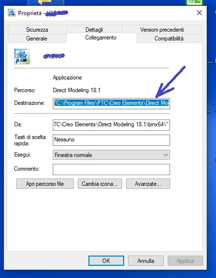

Can you see if on the other pc you have a folder called "ecs pdm client" or something?
p.s. would also be useful to know the complete path of the launch string, always talking about the pc on which everything works:
what is sincerely not very clear is whether the technician who made you the installation is an autonomous who knows the cad well and made you customizations or is part of a software house that sold you additional packages including materials, libraries etc.
because in the latter case you may also have problems managing additional package licenses; Moreover very often the additional packages have "centralized" customizations that are going to read text files that are on the server and not local, and this is meant to make sure that all business users have the same materials, with the same characteristics that always remain aligned even if a user should add a material and make other changes.
if instead your installation took place independently without servers etc, then it could be enough to search in the customizations of the computer correctly configured folder 18.1
and overwrite it to that of the new pc.
just write in the internal search bar %appdata% and
find all your personalizations, that of your interest should be in
c:\users\pc\appdata\roaming\cocreate\cocreate modeling 18.1
