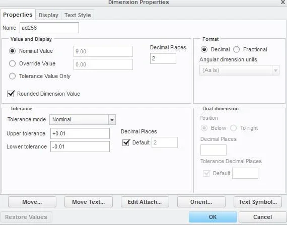

yes 320i, all about yes. Could you kindly give me a list of operations to follow so I re-make the setup from scratch and see if I get out of these blessed settings?
I'd be grateful
a list of operations by sector both the config and the drawing setup and be sure that the quotation drop-down menu gives me the possibility to insert tree and hole tolerances according to iso notation both on drawing and on part. I read something in the forum following the letter but the results are those that I exposed you in previous evening conversations no positive outcome.
In fact, it is enough for you both in the ".pro" and in the ".dtl" to put in the search the string "tol" and you get out all the options inherent to tolerances, there are many that control the display or not, see which you miss.
in .dtl there are many options that concern the graphic display of tolerances, those you can skip at this stage.
also check on the .pro file to have the tol_display option on "yes".
other I do not have on tolerances as setting.
Good evening,
Yes you with the find, to me it seemed to have appeared all with this research as you say, I will try again with expertise as soon as I have a moment of time and place the info that I set up on both .pro and .dtl. Thanks for now:)
Hello, kertus, I try to answer you for creo.
after putting the standard in iso, select all the odds that interest you,
file→preparousness model
tolerance→change→tabelle toll→recovery
you will see the tolerance selection window and, by selecting the first (hole_a.ttl) button shift and then the last follow-up to be opened, the regeneration message appears.
