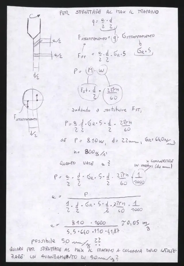

Guys, I have a problem in calculating the maximum advance to saturate the power of the column drill: It looks like I've got something wrong about the units, but I don't know where...
I attach the image of the calculations in the discussion. It is very important to carry out the report on the design of a flange production equipment employable on normal column drills. I thank in advance anyone who will intervene in my support.
