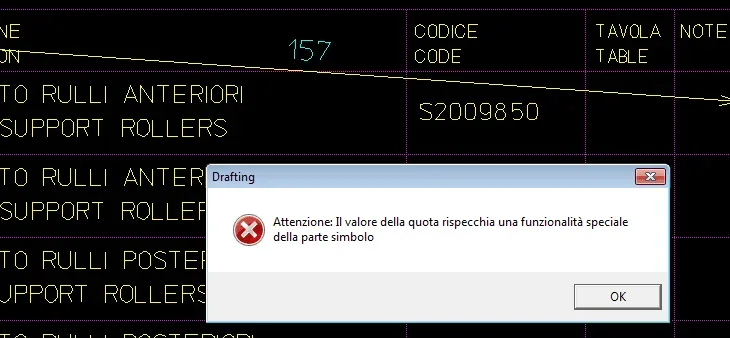

jim78b Guest May 30, 2019 #1 because if I say a part the message comes out: attention: the value of the quota reflects a special feature of the symbol part Attachments quota errore su parte.webp 29 KB · Views: 13
Stemox Guest Jun 17, 2019 #2 because you're listing a symbol part. a symbol part always has and only scale 1:1
jim78b Guest Jun 17, 2019 #3 but excuse me how I mistakenly created a symbolic part, is it different from the part?
Stemox Guest Jun 18, 2019 #4 I don't know how you did... as you put it you can also remove it from the menu "parts" is always an extra part with the symbol attribute, it is usually used for objects that must always remain in scale 1:1 like the carts or symbols
