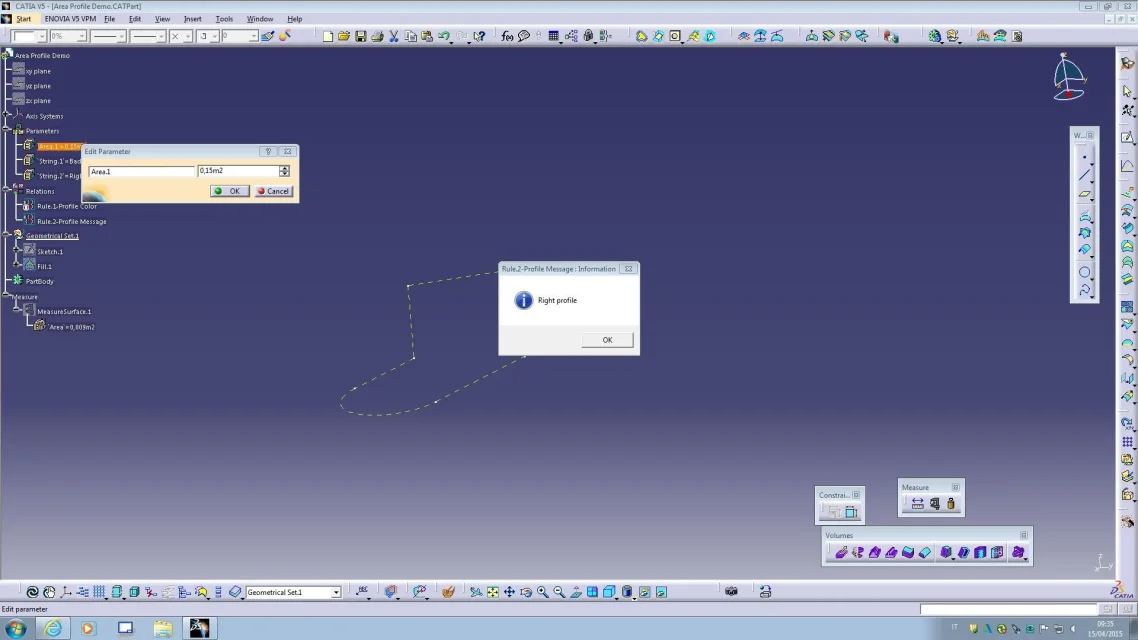

I send a demo that I believe can help
in cases similar to this ...
in the attached file I created a parameter
that fixes a limit area... (changeable to pleasure)
it is clear the sketch I will perform could exceed or not this limit.. .
comfort is that through rules
I can:
1-change color to the sketch output in case the limit is exceeded (then receive a visual signal)Rule Color.webp2-receiving a video message that signals me if the profile is "good" or "bad"Rule Message.webpthe whole is done by inserting, as you will see some parameters; a measure that detects the area
of the sketch, a limit parameter, and two rules, one for the change of color
and one for the message-
as you will see in the file are inserted both.. .
just click on rule and check (disable) to use only one ,
what you believe most useful to report to you the achievement and
overcoming your limit, preceding fixed-
to the
