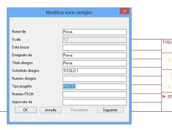

Good morning, I have difficulty in creating a cartouche that contains the voices I need. before proceeding to the realization of a table to be filled with values and figures by hand I would like to understand how it is possible to automate this process.
This is what I see when I try to change the cartilage:
Cartiglio.webpI explain: I would like to add to the cartiglio some voices (for example "group list") to which to associate more values (for example four names with related freshmen).

those voices that appear to you correspond to the attributes contained in the cartiglio (which is nothing but a dwg inserted as a block). open the card design and add all the attributes you need.
for the second problem just create two identical cards apart from the representation of the projection method
for the symbol you have to draw it, but not every time, enter the block (edit block) and:
1) drawings
2) exit the block saving
3) You always have it, when you put that cartilage on another design there will be the symbol.
for synchronization and modification of attributes, if I remember well command _battman
