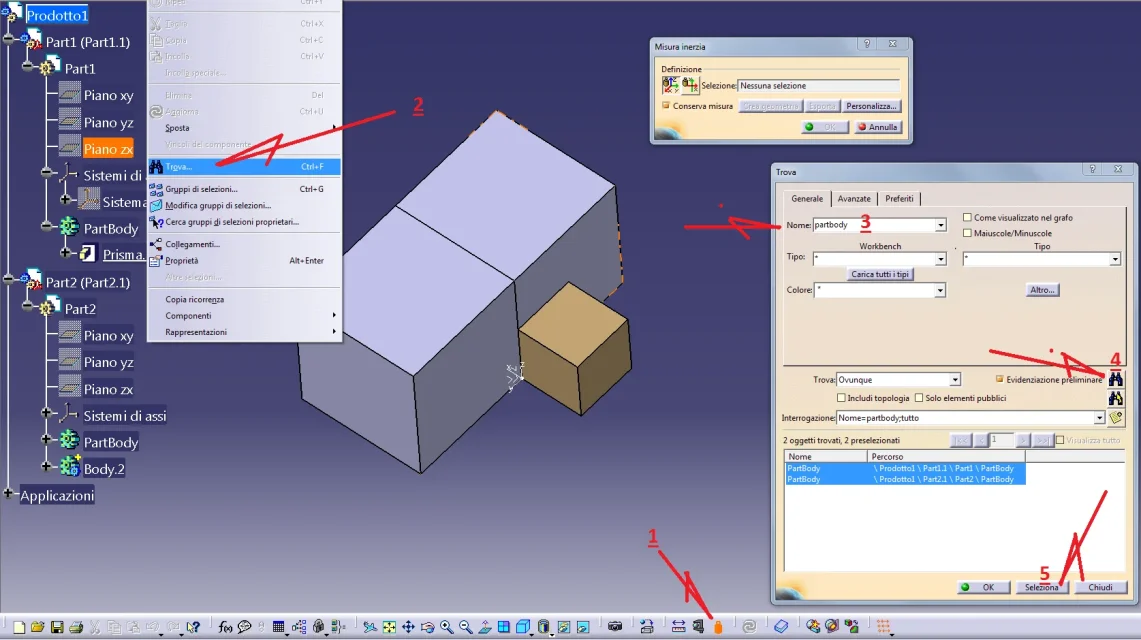

calcolo masse.webpIf you have given significant names you can use the find commando to filter the body.
1 calls the mass calculation commando
2 ctrl+f (or change menu + find)
3 type the name of body or partbody
4 clicks on serch
5 clicks on select or ok
calcolo masse II.webpHowever, I notice that with some catia licenses it may not work.
All right, we're clearing up, like always.
so, to exclude bodywork it is enough to enter the command finds, do an advanced search of the type "body" and then uncheck the unwanted ones (at the end of the project I am faster this method than rename all the body concerned).
ps: if someone wants to use this method, but after all the procedure, when clicking the "select" button (or ok) nothing happens, the reason is that in your selection there is an empty body.
There will be no specific error, but it will simply not start the calculation of inertia measures.
