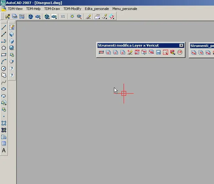

Hello everyone,
by autocad 2007 full version,
By mistake, by typing the "loadiupers" command for custom menus, I downloaded all the commands icons and the menu bar.
Now what do I have to do to recapture everything? I only have the customization commands that I uploaded from the .cui file, I can't find the file to load all menus and autocad commands.
thanks for the help
Palo

I uploaded a file to which customized, attach screenshots of the menu status.
to have complete menus and commands, do I reinstall autocad?

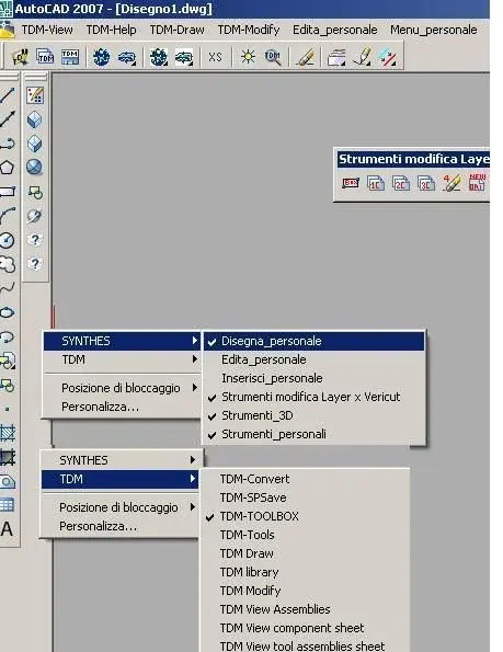

go "on the spaces" where the current bars are placed, right-click and find the list of bars to display.
already tried!
I don't find the menu bars, I only have my customized and x tdm tools.
all bars have disappeared when I accidentally typed from the "loadiupers" command.
I think I need to reinstall. .
