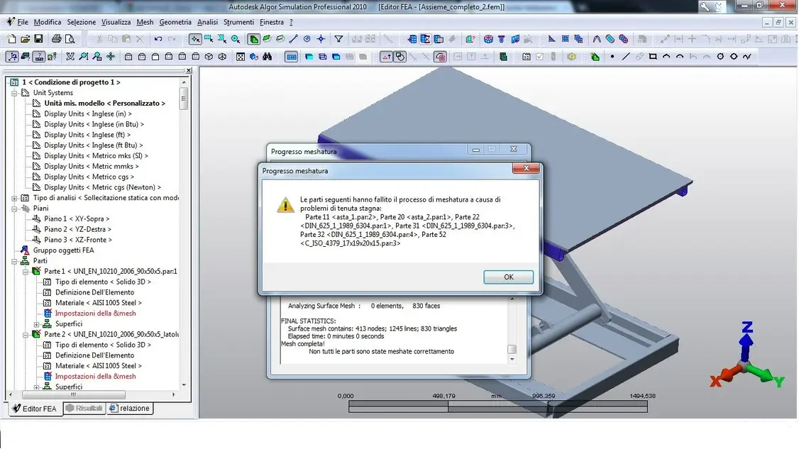

I'm an amateur with the fems.
for the 5th upper tesin I made the assembling of a table lift with solid edge I now wanted to do the analysis to the finished elements with algor 2010.
the procedure I follow is:
-imposed type of element (solid 3d)
-type of material
Solid mesh.
but when I make the mesh it gives me an error of stagnation on two rods and on the bearings, I checked and there are no interference and I tried to jam the mesh to the maximum but always gives me the same mistake.
I followed your advice and a friend's advice and managed to make the fem but I would like to understand what passage wrong (or what wrong) I tried with mesh more or less thick and to fix only the pieces interested by error but nothing (boh).
you will have left some "open" surface. ..check the lines well, somewhere you should find discontinuities!
