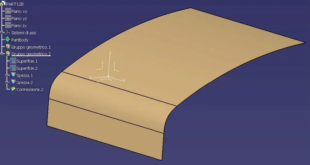

or finally some interchange! !
I should still understand from which surfaces start with v4, but to me it simply seems a fitting that you can create with a law or as in the image that I attach you with a connection surface.
the composition serves to close a series of pachs and ensure the tangence on the edges.
... let's say it's not exactly the same thing/result (see Annex ) ... in this specific case I may also "displease", but this does not remove the deficit that I cannot manage the control points of a surface as for example if I want to control a flexo or other... or other things about bows etc....
