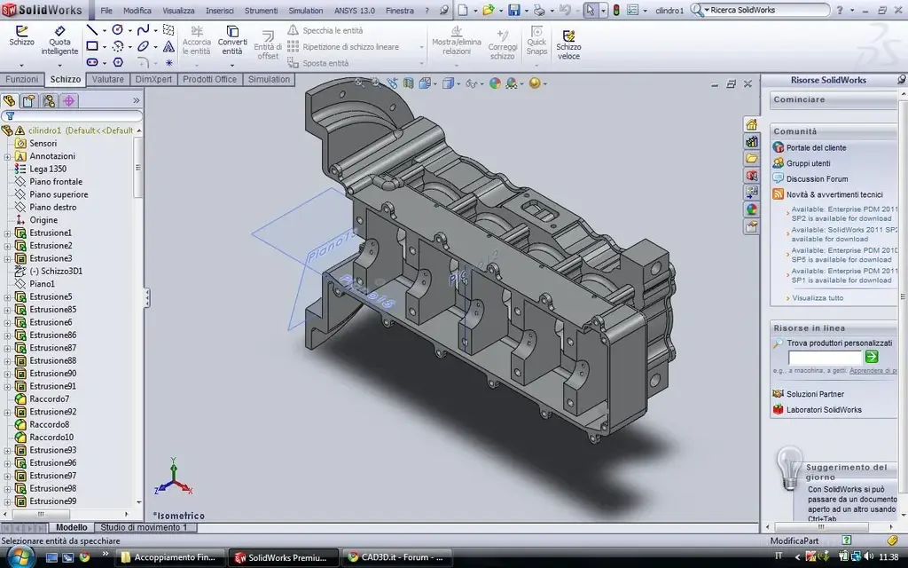

Is it possible to mirror a whole part?
That's what I want to mirror. .
Do you want to mirror all the monoblock motor according to the connecting plane of the headboard? or do you want to reproduce only the collage pattern between the head and monobloc?
I wanted to mirror all the engine block.. I arrived alone...it was enough to use the mirror function. .
the problem now is another.
I just need the mirrored part, the original part I don't need, I want to delete it or at least hide it.. How can I do that?

I to make a mirror part use 2 systems:
on the side they select the plan on which I have to mirror the part.
insert - mirror part.
from here you can hold the left side to the right or untie it completely.
otherwise . and to me this system piaccccccce.
create a support set where you put the right part.
make the mirror component according to a floor.
inside the function you tell him you want to create the opposite hand.
always within the option you tell him you want:
- or create a separate part (and return to before)
- or create a configuration (sx) within the original part.
if you choose this last option that can only be activated if you have sw2010., within the original part, you will find a non editable copy-setting function that will "command" the dx or sx part.
