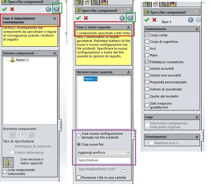

However, I return a moment on the mirroring speech by sending a very simple set from which we see how the mirrored object cannot mirror in a "natural" way without resorting to the opposite hand option and consequently the infamous creation of mirrored parts with prefix mirroring.
I can't figure out where I'm going because the mirror I want is the simplest one.
are two geometrically specular objects, the opposite hand is obligatory.
you will have to make two different designs and in the workshop they will have to make two different pieces.
